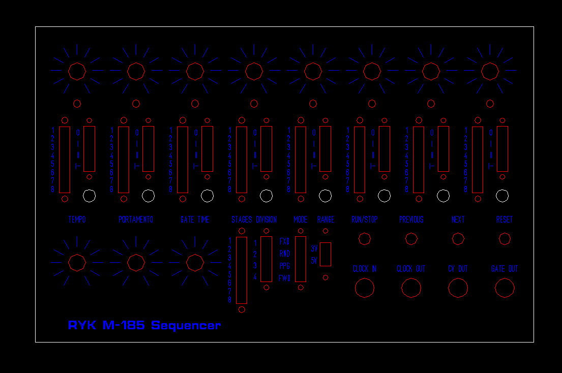

No need for an extra panel.
There should be room where the white circles are for small toggle switches.
Same goes for the 5u versions.

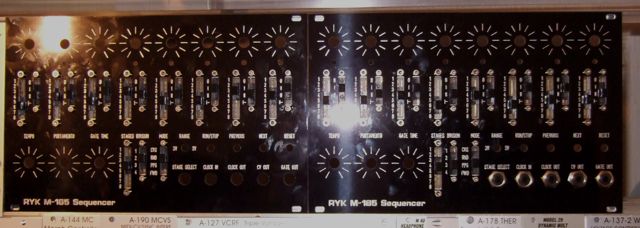

julian
Joined: Jan 11, 2008
Posts: 103

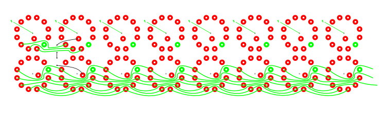

PostPosted: Fri Dec 11, 2009 4:54 am    Post subject: Reply with quote  Mark this post and the followings unread
what would be great would be to 'build' the switches in eagle. the rotaries are, i think, in the database currently, but the slides are not.
i tried using pads in the right physical locations, but, very quickly, it got too much for my brain to handle.
id like to make up pcbs more for neatness than ease of construction, but i think for the 2 boards i have, the effort in laying out the pcbs is going to be far greater than just wiring by hand : (
