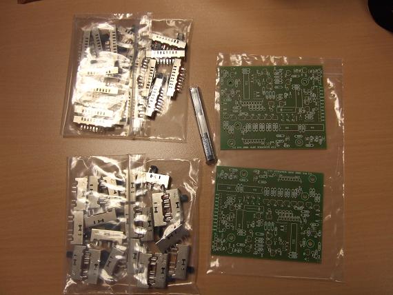

PostPosted: Fri Nov 13, 2009 4:53 am    Post subject: Look at what arrived today Reply with quote  Mark this post and the followings unread
Look what I found in my mail box this morning Very Happy
Nice one Ryk.
Now I just need a couple of panels and some time to put it all together.
 Filesize:  51.69 KB
 Viewed:  12592 Time(s)
