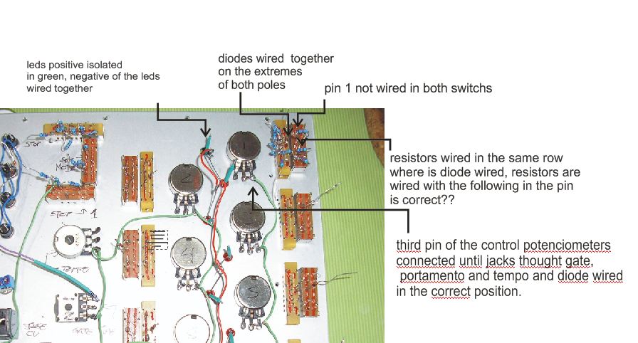

PostPosted: Thu Jan 07, 2010 12:32 pm    Post subject: more problems Reply with quote  Mark this post and the followings unread
hi again, i wired all connections, less pin 1 at all, and i have the following problems
.- the sequencer run
.- leds working in the order of the pots
.- start, stop, next, reset and prev, works
now the problems,
.- i have only a note on forever, not gate never, is like when you hold a key forever
.- tempo is very fast in the minimal position and light speed in the maximal
.- any potenciometer of the steps responds.
.- mode and step division doesn't work
.- the stage gate mode control and stage count control doesn't work
that is all, for now.
i hope somebody can help me. Can the people who finish the sequencer put pictures of the wiring? i think this pictures could be very helpful to people like me. Embarassed Wink
Fernando.
Hello
Sorry to hear you have a few problems.
I am away on holiday until end of next week, so am
unable to check the circuits.
But I will try and help a little until then.
.- any potentiometer of the steps responds.
Please check that you have the diode wired for each POT as
shown the wiring diag.
Does the CV out respond with the POTs ?
Are all the LEDs on at once ?
If yes to both questions then the wiring is wrong for the POTs
How many counts do you get per stage ?
Is it one clock pulse or more ?
Do the stage LEDs pulse per stage or full brightness per stage ?
Also make sure you wired the Stage Switches P1-8 in series, and not
the Q1 [pole] of the switches.
Check all the diodes are the correct orientation on the switches
Let me know how you get on.
-ryk
dancelwerk
Joined: Aug 28, 2009
Posts: 93
Location: berlin
PostPosted: Fri Jan 08, 2010 4:05 pm    Post subject: we will make it easy Reply with quote  Mark this post and the followings unread
hi again, i think is better for you follow the wiring job, i unwired all and start again, i built the xerox design, i take a picture for you is not a good picture, i will try to get another camera for a better macro pictures, but i think is better to correct possible errors and could be a good tutorial for future amateur builders like me.
look the picture and say me if i am going in the correct way.
thanks a lot and sorry to be a pain in the ass Embarassed Embarassed
