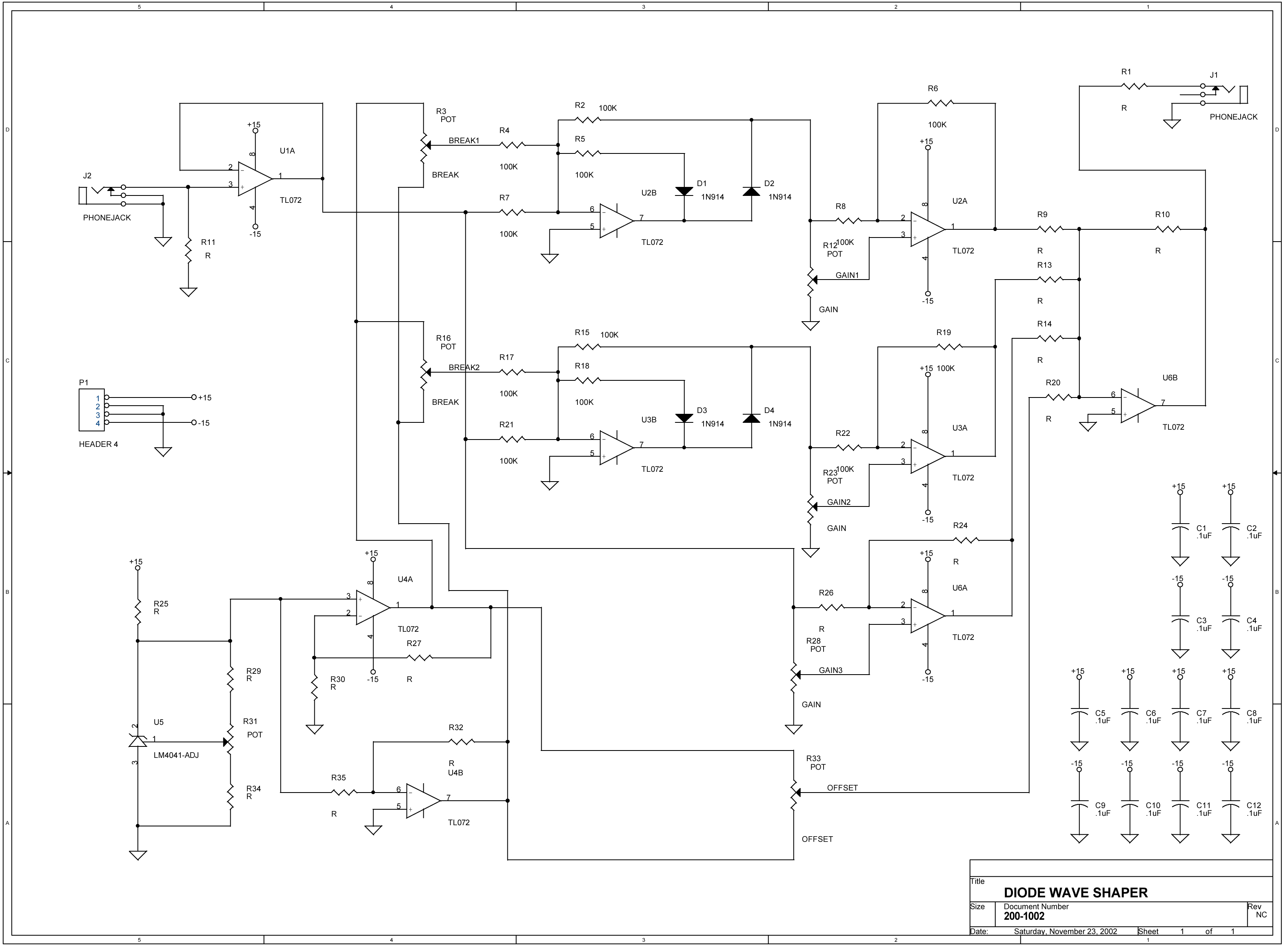

    Diode Waveshaper by Jim Patchell from his page : Complex CV Processor
    Similar to the simple processor, except, you can set two break points where you want the gain of the module to change. In this way, you can shape an incoming signal if many ways. This module was primarily intended to be used with the filters to create phonemes. link: http://www.oldcrows.net/~patchell/synthmodulesII/index.html
