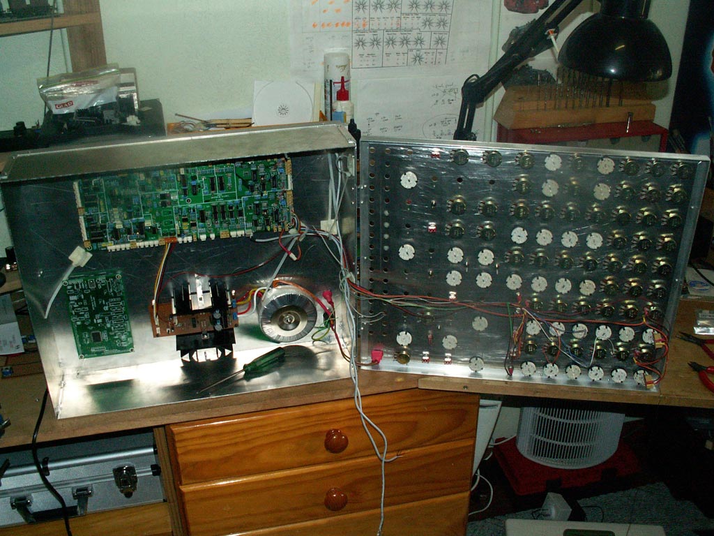

PostPosted: Sun Oct 22, 2006 7:22 am    Post subject: Reply with quote  Mark this post and the followings unread
Here are the latest pics.
Here's the case finished. It turned out solid as the proverbial brick shithouse!
 Filesize:  175.73 KB
 Viewed:  489 Time(s)
Front panel, half dressed.
 Filesize:  184.71 KB
 Viewed:  558 Time(s)
What's inside, with the oscillators half wired up.
 Filesize:  160.69 KB
 Viewed:  548 Time(s)

I've just finished wiring the VCOs, and I've realised that I need to do some fine tuning of the +/-10V reference. R1 & R4 were originally s'posed to be 267R and 287R (not sure why) now the updated schem shows them as 270R. I'll change them to be matched 1%, and the 1K5s, for which I used 5% carbon, I'll be changing to 1% as well. Laurie says on that schem to adjust the 1K2s for perfect +/-10V so I'm going to put in 200R 25 turn trimmers in series with 1K1s 1%. Aside from that everything seems to be working fine.

Yep,
I've got the oscillators running. I need to work out a problem with the V/Oct tracking, then I'll move onto the VCFs. I'll post some samples as soon as there's something decent happening.

PostPosted: Sat Oct 28, 2006 3:59 pm    Post subject: Reply with quote  Mark this post and the followings unread
sneakthief wrote:
re. v/oct tracking - Laurie's instructions didn't work at all for me. Since both of my vco's have the same issue, I think there's something fishy but I haven't quite figured it out yet.
The problem I got was that with a CV of 5Volt I couldn't adjust the V/Oct trimmer to get 5 Octaves difference from the original frequency. I could only get just over 3. Is this what happened for you too?
The newest update of the schem shows 2*TL084s in each VCO, now, even though my original BOM shows TL084s, for some reason I've got two LF347s installed. I put them in ages ago so I've forgotten why that is different. What quad op-amps have you put in yours?
I've already e-mailed Laurie about it, and I'll keep you informed about the fix. Apart from this, it sounds really good, and the waveforms are very close, without me even doing any shape adjustments yet. I'm sure it's something simple.

I've got 2 tl084's per vco. My problem is that when I use 5v on the cv-input (with nothing else connected), I can get the proper frequency, but the tracking is wonky.
That said, I can still get several octaves of decent tracking, just not as many as was claimed. As I said before, I think this might be related to my +/-10v reference not being calibrated yet.
michel
Sneak-Thief - raw electrofunk
PostPosted: Sun Oct 29, 2006 2:44 am    Post subject: Reply with quote  Mark this post and the followings unread
I checked the datasheets for the LF347 and the TL084 today, and the large signal gain for the 347 is 100 V/mV whereas the 084 is 200 V/mV. I'm pretty sure that's my problem sorted out right there, but I'll see what Laurie reckons.

just got a message from Laurie: seems that TL074's may be the way to go for the exponential converter (instead of a tl084). i'll try this it and report back how it works.

PostPosted: Mon Oct 30, 2006 4:36 am    Post subject: Reply with quote  Mark this post and the followings unread
I changed over the exponential converter opamp to a tl074 and I now get good tracking over 5 octaves. Great!

PostPosted: Sat Nov 11, 2006 6:18 am    Post subject: Reply with quote  Mark this post and the followings unread
Both VCOs and VCF1 wired up and running really well.
It turns out that I had some old component values and a couple more things to sort out with this "prototype" board I got. I've tracked it all down and sorted it out. I definately feel like I'm learning more and more as things progress.
I've got to get some modulation sources happening! Very Happy Rolling Eyes
