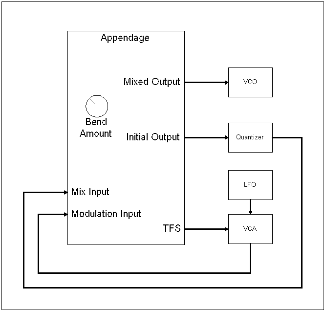

Well, the Appendage was designed for skinning cats, so there are a number of ways of doing things.
For example, even a simple 8 bit quantizer could set the intial note value, the bend voltage could be used for smooth, unquantized slides, and TFS could be even used to control the amount of modulation (unquantized), if the Appendage is in current mode.
That's what this patch would do - if the quantizer has a level input, that would set the range, otherwise one could pass the initial signal through a level control. The mixed output would provide the blend of quantized voltage, bend and modulation.
Mixed output could be used to connect to the filter for tracking, or one could put in the bend voltage, or use slide, or TFS for various filter control options (not to mention the whole EG control provided by gate and trigger output).
 Filesize:  6.39 KB
 Viewed:  201 Time(s)
Nice patch, sure this would work. To play new notes, one would have to poke at the ribbon for each new base note, but sure this would work. I like the use of TFS output for vibrato depth control. I would assume the VCA would be in linear mode of operation.
If one wanted to glide over a range of notes, the INIT could be replaced by the slide output. A simple 8 bit quantizer like the Blacet Miniwave could be used along with their Mixer/Processor for level set. I use these as example because I have these modules on hand and will be interesting to experiment with in the next prototype phase of the project.
