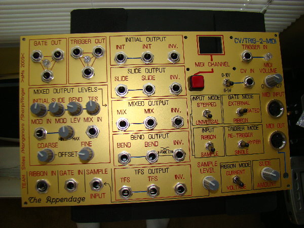

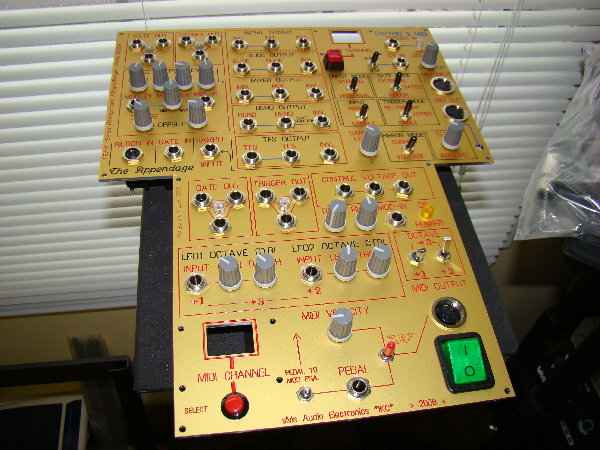

PostPosted: Sat Mar 07, 2009 8:29 pm    Post subject: Reply with quote  Mark this post and the followings unread
Here is a picture of the finished panel for the Appendage.
Bill

PostPosted: Sun Mar 08, 2009 2:49 am    Post subject: Reply with quote  Mark this post and the followings unread
Wow, nice board! How did you do the printings? Laser engraving, milling?
Are you using the Arduino as the MIDI processor?

PostPosted: Sun Mar 08, 2009 7:44 am    Post subject: Reply with quote  Mark this post and the followings unread
Franky -- The MIDI portion is indeed handled with the Arduino. In fact, I will be using your library for handling the MIDI stuff. I had some code written without the library but will modify it to incorporate calls to that library. It will make the code lots cleaner and I believe your library uses only about 1500 bytes. I will have plenty of code space and will most likely stick with the ATmega168 with 16K of flash memory. After bootloader (2K) and the MIDI library (1.5K) , I have 12.5K for my code.
After Appendage prototyping, that the last thing that will get fully developed. I will publish the schematics and code of course in the spirit of Arduino. Cool
If I want to expand the analog inputs on this incarnation of Arduino, I will end up using external analog switches to scan more inputs for sliders, buttons, and CV from the Appendage. I want to have this sort of expansion because I want to use it with my IKC keyboard controller as well.
http://electro-music.com/forum/topic-29746.html
Have you had feedback of others using your MIDI library?
The board you see there was designed with ExpressPCB. The panel was designed using "Front Panel Designer" from Front Panel Express. Th material is anodized, engraved, aluminum and then filled in with any color of several you can choose from. They do the manufacturing for you.
http://www.frontpanelexpress.com/?gclid=CNy-0JbIk5kCFQEpGgodk3qlaQ

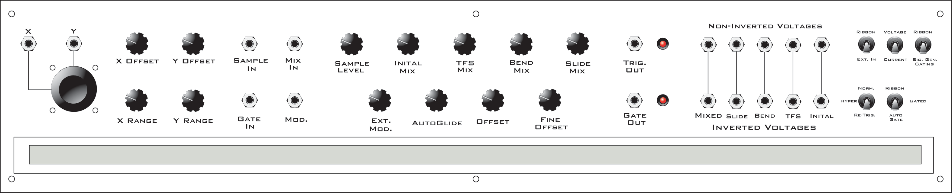

PostPosted: Fri Mar 27, 2009 5:51 pm    Post subject: Reply with quote  Mark this post and the followings unread
Here's my first crack at an Appendage panel. It's still a little rough. I post with hope that someone from Team Appendage® will offer some critique. Let me know if the control groupings don't make sense or if I've forgotten or mislabeled anything. This will be the largest panel that I've ever tried to etch, so I'd like to get it right the first time.
The panel will be mounted almost horizontally (15˚ slope) as part of the controller that I'm building. On the left most side I've incorporated a joystick that isn't part of the ribbon controller. More details soon. Thanks for looking.

PostPosted: Fri Mar 27, 2009 7:02 pm    Post subject: Reply with quote  Mark this post and the followings unread
Dang, looks like you nailed it to me! Nice panel, indeed, very well laid out IMO. The controls are right there so's you can tweak things very immediately - it's a good performance setup, especially with that joystick right there. Looks made for mayhem!

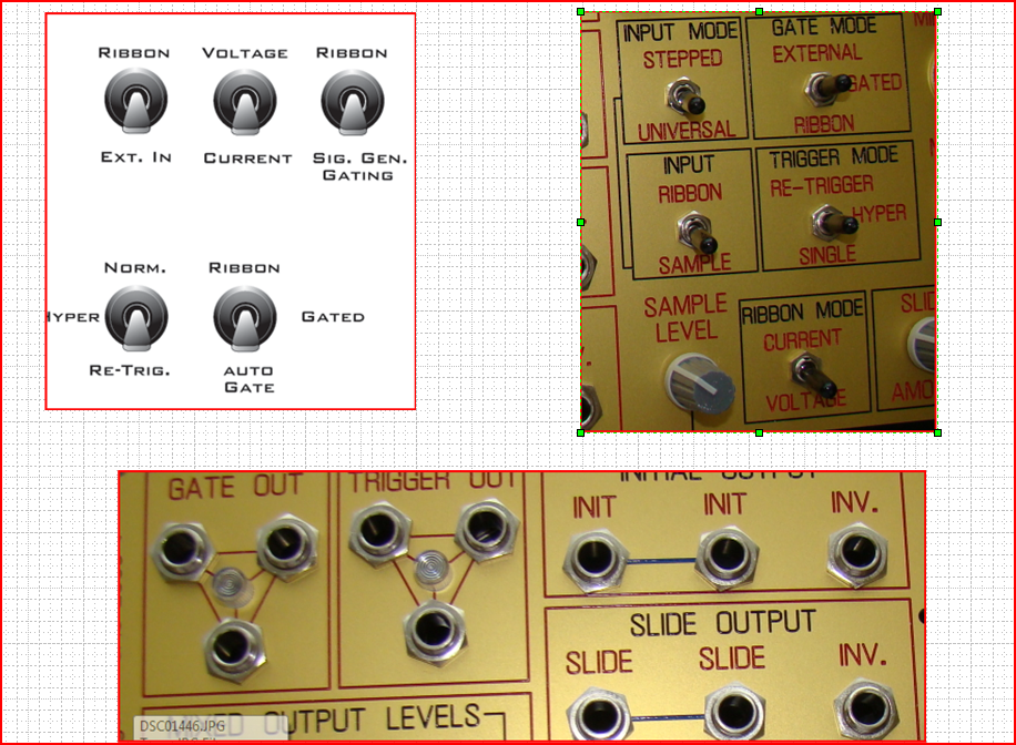

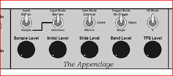

PostPosted: Fri Mar 27, 2009 7:09 pm    Post subject: Reply with quote  Mark this post and the followings unread
Peter, very nice panel indeed !!! I just want to make a suggestion. Take a peek at the picture I have attached. It compares your switch position vs. function to mine (and Scott's) The documentation that will be supplied on how to build your panel will be based on the switch positions on my panel. If they are oriented like yours, things will just get confusing when you go to test your Appendage ans some functions will appear to function in reverse. Also, the signal names on my panel are what we (the TEAM) generally agreed would make the most sense BUT that's really a matter of your preference so you can call them what you wish. Wink
I would also suggest MULTI's .... you will most likely want more than one destination for a TRIG, GATE, or CV .... I added multi's on all these signals to avoid needing an external multi. Just a suggestion.
I wil assume you are mounting the ribbon onto the panel so there is no need for an input jack? If you decide to go with a jack input, it must be an insulated TRS type jack. We are using Switchcraft P/N N112BX Mouser P/N 502-N112BX
http://mouser.com/Search/Refine.aspx?Keyword=502-N112BX
I see the Joystick, very cool ...... Cool
BTW, are you coming down to Analog heaven this year? I will bring my Appendage for everyone to play with. Laughing Laughing
Bill

PostPosted: Sat Mar 28, 2009 7:20 am    Post subject: Reply with quote  Mark this post and the followings unread
Thanks guys
Bill that's just the kind of feedback I was looking for. I totally forgot that yr. panels were posted here when I started mine. I'll take a look at your layouts and move some stuff around and add some mults. I'll repost rev2 soon.
BTW: Is the stepped/universal input mode an add-on or stock?

PostPosted: Sat Mar 28, 2009 9:47 am    Post subject: Reply with quote  Mark this post and the followings unread
Stepped/Universal is stock, though you wouldn't have to install it (you would have to wire it in one position on a connector internally). You may want it though - it goes good with the Klee, for example. "Stepped" is designed specifically for stepped voltages that a CV keyboard or a sequencer would put out, while universal treats any input signal as a standard S&H/T&H.
In stepped mode, the Appendage synchronizes with the input to provide autoglide, gate and trigger signals at the right time. Autoglide will kick in after a gate input is received; initial will hold the first note and slide will output a continuous voltage tracking any change from initial that comes in while the gate is high. Bend will put out the difference between the initial note and any changes that occur while the gate it high. The upshot is, if you are using a keyboard, if you hold down a key and play legato, the AutoGlide will affect the notes in between, but will not glide if you release all keys, then play another - so it acts as a legato portamento. A sort of half-duplex duophony is possible too - a VCO controlled by the initial voltage will hold that first note, and a VCO controlled by the slide voltage will play the first note and any other note in the legato passage. This mode allows the discriminator in the Appendage to detect changes in notes, prompting a re-trigger (if desired).
