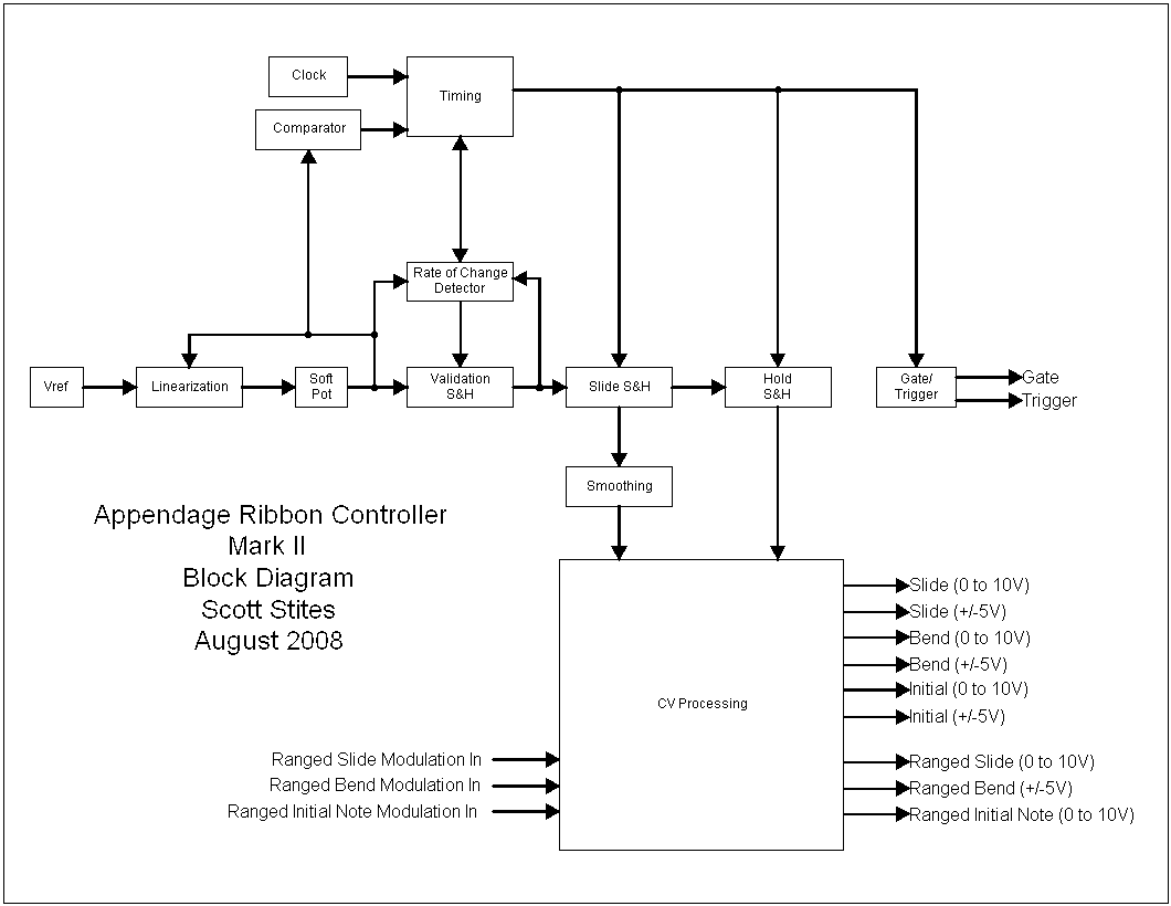

I'm pretty well finished with the core circuit. Here's a schematical block diagram of it - I haven't put in the values yet - I won't release that until I work out the range stuff, which for now is a simple buffered voltage off of the rail. It will ultimately be a regulated reference voltage.
The SoftPot itslef proved to be a challenge to fully understand and tame for this application. The generalities were easy enough, but the nitty-gritty stuff took a bit of thinking. It was easy enough to apply voltage to it and make it go up and down, it wasn't quite so easy (at first) to acquire the voltage, hold it, and produce gate/trigger signals. But the really challenging part was dealing with what the SoftPot does in that nether region between gently pressing and releasing. It wasn't thinking as linearly as I wanted it to. Pressing it, then releasing softly, then pressing again would cause the analog shift register to grab bits and pieces of the convoluted fluctuations the SoftPot went through. Think of a finger controlled S&H circuit processing a noise generator, and that's pretty much the effect.
After some thought, and no small amount of flat out swearing, the solution finally occurred to me - it was staring me right in the face. The analog shift register was designed to grab events that happened in the very near past and turn them into a present occurence. It was relying, in large part, on chance. So, why not focus it to determine if the Softpot was having a momentary hissy and just ignore that hissy? I did that by comparing the output of the first S&H and the second S&H and ensuring that the two levels were within a certain window of voltage over a certain amount of time. If the difference falls out of that window, S&H 3 ignores the results, and the first two S&H's try again. Only until they agree is the voltage considered a valid voltage, and S&H3 is allowed to sample it. The window itself must be wide enough to ensure a continuous slide over time (estimate how fast a person could slide anything across the ribbon, then use that as the criteria for the threshold). At first, I miscalculated how long the SoftPot might hang onto a certain erroneous level - I severely underestimated the time. I finally figured the right clock frequency, and the SoftPot is as solid as a rock and as smooth as a baby's behind. I've been using the circuit for two nights in a row, and I'm very, very pleased with the results.
This is the core of the Appendage - it takes a pressure event and translates it into three unique control voltages (continuous, intial value and differential) and produces the timing signal for gate and trigger. Everything past that is downhill. These signals can be manipulated to do an astounding number of things, simultaneously.
The way I see it, if you want a standard ribbon controller, go buy the Doepfer. From the videos I've seen, it's pretty cool. The Appendage, however, is going to be a different beast. I envision it as a cross between a ribbon controller and a Buchlian gestural controller.
Position, relative position, rate of movement, direction of movement (split even into different directions) will be able to control any parameter your synthesizer has, simultaneously. Mixing these control voltages is fascinating. For example, the amount of control mixing differential with initial provides is surprising. Mixing slide with initial creates a sort of hyper-range. Slide with slide bends the curve radically. I've even discovered a neat trill function (quite by accident).
I'm already thinking of the DAC circuit, which is down the road. It need only grab the S&H3 and S&H4 voltages for infinite hold (everything is really derived from those two voltages). I figure a half note step quantizer will fit in as well quite nicely.

Today I breadboarded a second circuit from my schematic of the first. I did change the positive logic ICs to M2L (CD40106) so there wouldn't be any underused ICs taking up space. Other than that, the circuit was identical, and, much to my relief, it worked right off the bat.
This gave me an "unfuzzy" breadboard to work with. When I put it together, I left some extra room around the analog shift register section. One of my goals was to improve the performance of S&H 3 and S&H 4 (the two S&Hs that provide the voltage outputs). I was getting an abysmal 90 mV/minute droop, which I couldn't do much about until I had some room to get in there and work. I put in a CD4047 and an extra LF398 on S&H3, calculated values for pulse width, routed the path accordingly, and turned on the juice. I then opened up the VCA and played a note, waiting to hear the droop. I waited. And I waited. And I waited some more. I began to doubt that the VCO was under control of the thing - I hit another note. Nope - it was controlling the VCO. Dumbfounded I hooked the DMM to the S&H3 output, hit a note and watched my watch and the DMM.
It was a full three minutes before the voltage dropped 1 mV.
Shocked
Never in my wildest dreams did I think I would ever get a sample and hold to do this on the breadboard. This thing does not need a DAC, unless you're planning on holding a note or a control for an hour or so.
Needless to say, I didn't waste any time rigging up S&H 4 with the same circuitry. The Appendage has landed - it's now performing beyond all my expectations. Even though the SoftPot is still loose on the bench, it feels like a musical instrument. I can't remember the last time I was so elated over a circuit.
Here's a sample I recorded a few minutes ago. Again, the SoftPot isn't mounted to anything, so I can't really freely whack on it like I want to, but if you've heard the previous samples, you should get a feel now for the improvement in the thing.
It's CV2, which is the fixed voltage, controlling two VCOs. The trigger output alone is controlling an EG. The EG is long attack/release and is opening the VCA and modulating the filter. Both VCOs are going through my 2040 clone filter and through the VCA. I've got the differential output controlling the cutoff of the filter as well. When I slide up, the VCO pitch doesn't change, but the filter opens up. When I slide down, same thing - filter closes, VCOs don't change. Differential only changes from zero when there's a slide, or a hammer on while the pressure is still applied -it only changes relative to the point where the note was initially played, which means you have a considerable amount of control over the filter as you play.
CV2 is unique, because it is sampled only once per note - so it's a fair example of the new S&H, though a true sample demonstrating that would be a verrryyy long one-note sample.
This was all recorded in one take, through my Lexicon MX200 straight into the recorder.

Wilba - I must chime in with State Machine and say welcome!
I'm pretty sure this would work for interfacing with the MIDI box. It's certainly possible to get a two-note response with the Softpot, but I didn't start off in that direction. I have thought about putting that sort of functionality in, bearing in mind using this glitch-gar method, it would require a bit more circuitry.
Uncle K: Pretty nice tag line!
Bill: I have to say, I would never have been able to get this far without that nice package you sent a couple of weeks ago. It would have been impossible without it.
Ringer: Yep - I have controlled a VCA with it (to control the level of an LFO modulating the VCO - a lovely patch with a ribbon controller). This design has positional "memory", so that that CV1 and CV2 outputs put out a voltage relative to where the pressure is applied, and when pressure is withdrawn, the voltage stays at that level. The "bottom" of either of these two CVs will always have some voltage. The differential output is what you would use to control a VCA. The differential output is relative to where you first apply pressure. Offset doesn't figure into it.
Differential starts at *zero* volts no matter where you touch the ribbon. If you slide up from that point, the voltage increases positive. As you slide down to the point you originally touched the ribbon, the voltage slides to zero again. If you slide down past the point where you touched it, it slides more and more negative. It does have memory, so, say you open the VCA, then remove the pressure, the VCA stays open. Then, the next time you press the ribbon (anywhere) the voltage falls back to zero and the process repeats. It is possible to switch it to a non-memory mode - IE, when you remove the appendage, it immediately falls to zero. If you lag the voltage, it would glide down perhaps a little more satisfactorily rather than just snapping off. Of course, with memory, you just glide your appendage down to close the VCA then remove the appendage.
Implementing the differential permutations I plan to incorporate, you could open the VCA by sliding up past intial contact, and/or sliding down from initial contact. You could even open one VCA by sliding up and a different one by sliding down. That's the power of DIY - you get to do exactly what you want to do. Very Happy

Tonight I put in a small sub-circuit to linearize the response of the last couple of inches of the SoftPot. Without this addition, things are pretty well linear up until around the last two or so inches, and then things climb for the last 20% of the range. It appears the response is somewhat exponential. It was, anyway, not anymore!
That was the last link in this version. Now I'm going to try for reduction of parts though none of the blocks can be done without - last night I spent some time seeing if I'd made any changes that would render any of the circuit non-essential. I did this by by-passing the functions, but they all work together in lock-step to make appendage sliding a pleasure and not a glitch-fest.
I think I can reduce the parts count in the ASR portion by going to simpler S&H topology for S&H1 and S&H2 - just as long as they can carry a voltage accurately for a split second or so.
I'm thinking I'll leave the hooks in this board to accomodate the two-note variety via a second board, which would also hold the voltage permutations, retriggering, and slide velocity, etc. This circuit could be held on a single board, but the circuitry for what I have in mind for two-note operation would put it over the edge. This version makes a great ribbon controller, and also I think it's a nice interface for smaller control ribbons to mount on keyboards, etc. And it'll be required for the two note version - the Double Appendage? Laughing .
Anyway, one of my goals is to make it with parts that are easy to get - it contains the following ICs:
TL074
CD4013
CD4017
CD4093
CD40106 (74C14 works fine, too).
LF398
ICL7556 (low current version of the 556, which would also work, but I don't recommend it for anything. You'll need more caps if you want to use a 556).
It uses comparively few discrete parts (resistors, caps, diodes, transistors).
It will provide the following output voltages, max 10V each:
Raw Continuous Slide CV
Raw Fixed Note CV
Raw Differential CV (auto zeroing bend)
Ranged Continuous Slide CV
Ranged Continuous Fixed Note CV
Ranged Differential (auto zeroing bend)
Gate
Trigger
With the following controls for the ranged outputs:
Continuous Slide Range (potentiometer - not sure if there's enough room to put in a calibrated range rotary switch - mebbe)
Fixed Note Range (potentiometer - again might be switchable)
Differential Range (potentiometer, again with the switch note).
Fine Tune Pots for all of the above
Offset
Fine Offset
Bend level pot for ranged fixed output (basically mixes differential with fixed note) - an absolute must - much more controllable than the continuous slide in many cases, and it's cool, trust me).
The number of controls and outputs used are up to the builder. This could be a module or a full-blown rack (considering what's coming down the pike). Or it could be a self-contained unit. In the case of a module or a rack, I think a single stereo 1/4" TRS connector would work for interfacing the ribbon to the module/rack (like on a foot controller). Then you could strap it on, wank away, and steal the groupies from the guitarist.....
It's also the basis for a number of specialized controllers that I can't stop thinking about (like the touch sequencer, etc).....I need sleep......
I'm certain it'll work with either +/-12 or +/-15V, though +/-12 might require some different resistor values - remains to be seen.

Bend: You press the ribbon, which initiates a trigger and holds the gate open as long as pressure is applied. The CV level (amount of voltage) is set to 0V, regardless of where on the ribbon the pressure is first made. While applying pressure, sliding to the right slides the voltage more positive and sliding to the left slides the voltage more negative. Sliding to the initial point of contact returns the voltage to zero. Releasing the pressure holds the voltage at the last value that was generated before release.
Obviously all of these voltages occur simultaneously. The ranged voltages are suited for controlling pitch (though they can be used for modulation purposes as well). The unranged voltages are suitable for modulating anything in the synth. The modulation inputs will modulate each of the ranged voltages, which is a powerful tool. Not shown are the controls that will allow interaction between the voltages. Mixing Bend with Initial allows a variable amount of bending to a fixed note. You can have just a small range for initial, and a wide range for bend, or vice-versa. A mid-range setting for initial and a limited range for bend modulation really produces a nice saxophone type of pitch bend, for example.
I've never had anything open my modular up like this thing. I was controlling a CGS Wave Multiplier with it last night - bend into the folds input and slide into the offset input, while initial+bend was controlling the pitch of the VCO passing through it. It was marvelous and very organic...
I'm hoping all of this will fit - I think it will - into a board about the size of the Klee Digital Board. I'd really like to see the voltage permutations included as well (which are not included in this diagram).
The next task will be a "duophonic" version.
Cheerios,
Scott
Appendage Mark II Block Diagram
 Filesize:  14.66 KB
 Viewed:  683 Time(s)
