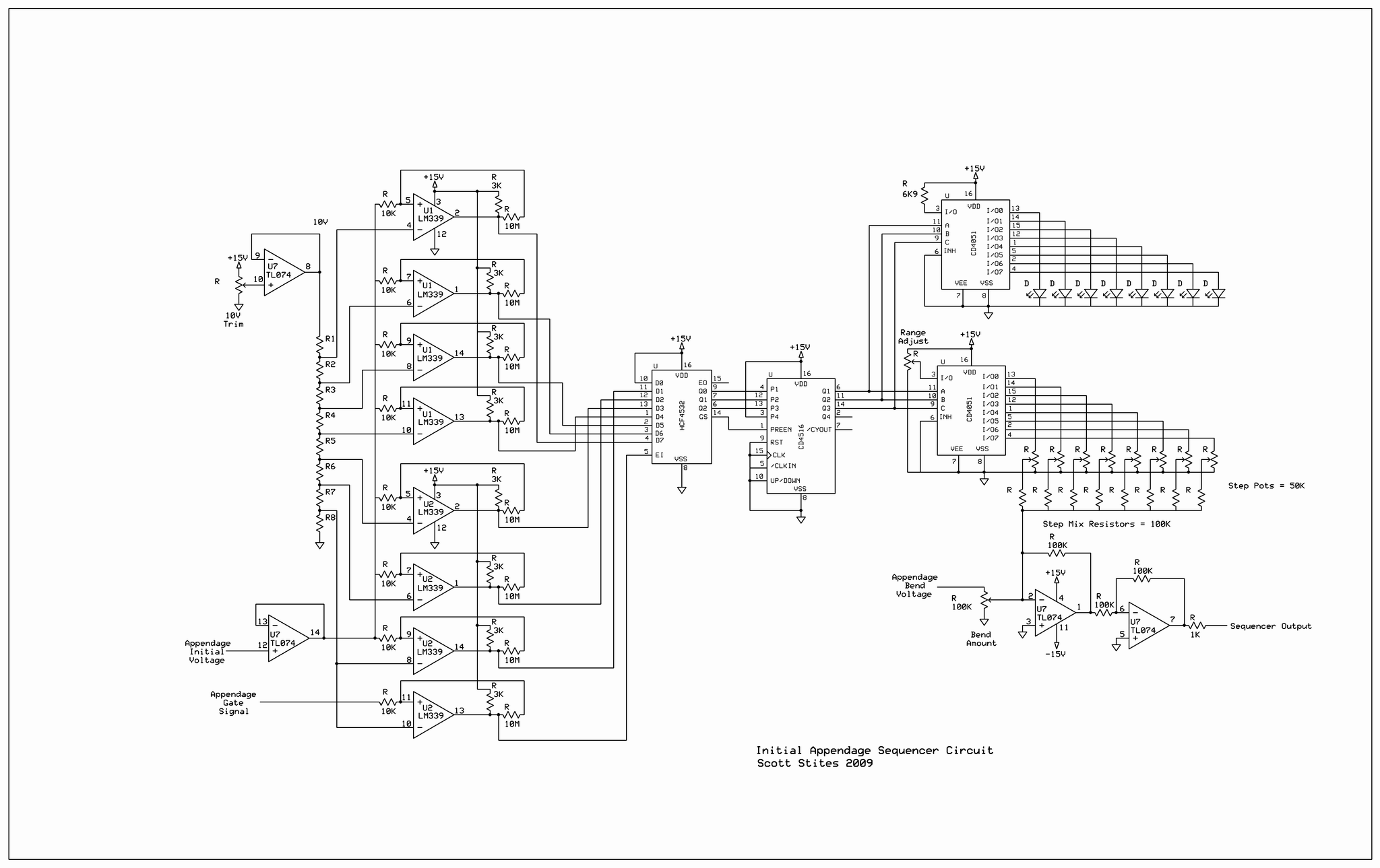

Sure, no prob. I don't think everything in this circuit will be needed by a CV address system - it's sort of Appendage-centric, but it'll probably get you pointed in the direction you want to go.
This is just a quick "Is this worth it?" validation - I wanted to see if the concept was worth the effort (I certainly think it is). So, stuff like how the 10V reference and range control are implemented are just expedient contrivances. Same thing goes with the CD4516 config - the hooks are there for clocking, direction, etc, but not installed. I just wanted to see if the addressing was a good thing to have.
I'm not crazy about the LM339 performance here. The hysteresis values were taken straight from the datasheet, but on the decision points between steps the 339 still can break into oscillation if you hit the exact point on the ribbon. I'll probably look at going in a different direction there (I went with LM339s because I have a bunch of 'em). Heck, maybe an LM3914 in bar-graph mode would work. In any event, the direction I'm headed is to incorporate this into a linked/synchronized 8X2/16X1 sequencer that I actually designed back before the Klee. May not be necessary, because Bill is a whiz with programmed parts.
6K9 is my value for my low level LEDs; it can be any value you like that drives an LED to the brightness of your hearts desire. The resistor string is made up of 10K resistors, BTW (I neglected to put that value on the schematic).
In any event, this is the exact circuit I used on the last two videos.
Cheerios,
Scott
Appendage Sequence Initial Schematic

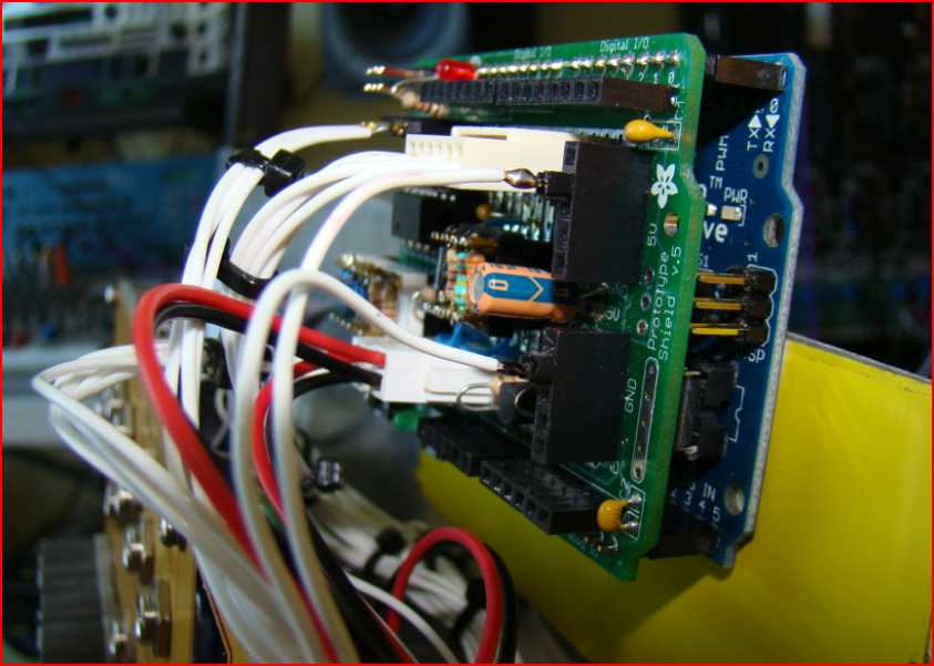

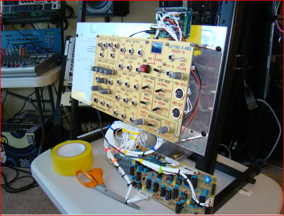

According to some guy by the name of State Machine, his Appendage has gone MIDI (I'm sooo glad I named the thing "Appendage" Laughing ).
He sent the proto-group an email a couple of days ago:
I am excited to say that I tested the MIDIfication (Phase 1) of my Appendage tonight and I am very excited about this. I setup up the Appendage along side my computer rig running Ableton LIVE and an instance of Spectrasonics Omnisphere "power synthesizer"on a MIDI track. I then patched the Appendage MIDI OUTPUT to my Novation MIDI interface, Port 1, connector and set the channel to accept MIDI data from this port at the channel set by the Appendage digital MCC unit. I used "MIDI -OX" for MIDI data analysis to view the incoming data from this MIDI port along side my sequencer. The analog MIX OUT of the Appendage is "normaled" on my panel to the CV input of the CV2MIDI adapter as well as the GATE OUTPUT to the GATE input of the CV2MIDI adapter. They can, however, be patched over from other sources by simply inserting a jack. It was tuning time. As I viewed the MIDI note data and tapped the low and high points of the ribbon, I adjusted the INIT & OFFSET controls to set a 2 or 3 octave span across the ribbon, 24 or 36 counts respectively.
The fun then began !!! I layered 3 patches at a time in Omnisphere and played for about 3 hours straight !!!!!!! Holy cow what fun that is ..... Scott, your Appendage and my CV2MIDI adapter work so well together !!! This is so much fun playing my digital and analog synths using a single RIBBON CONTROLLER. Now with this AND the IKC, I can simultaneously control my analog and digital gear .... This whole thing sunk into one big package will be soooo cool !!! The master plan is coming together !!
This is THE FIRST MIDI capable Appendage !! Next, I will add MIDI continuous controllers (CC's) to my firmware and digitize the SLIDE, BEND, TFS. With a small modification I shall add [4] 2:1 analog switches, thus I will then have a total of 10 channels of analog signaling I can digitize with up to 10 bit resolution on each channel but right now my firmware divides full scale by 8 so that I can stuff 7 bit values into my MIDI data stream. Right now I use one CV from the Appendage, and a master VOLUME "CC#7". Adding the SLIDE, BEND, TFS will account for using 5 channels with 5 left over for other MIDI controllers that I can route into my software synthesizers. This is Phase 2.
Bill went on to explain phases 2 through 5, but I'll let him reveal that in his own good time.
This really excites me - I'd love to control my humble SH-201 with my Appendage. Speaking of Appendage, the design has been in the can for a fairly long time. What's holding things up is me - I've got about two thirds of the build doc done.
Pics of Bill's setup: I probably should let Bill point out what is what - I may be getting things mixed up!

Scott, thanks for posting this information and photos of which I will explain in a moment. Phase 1 is complete. Phase 2 is in the works and 90% of the software has been written and tested and the extra circuit board is being constructed with the remaining phases of the project are outlined below. I hope this will be a part of a line of new expansion boards that can interface to the Appendage Touch Ribbon Controller. The first photo from your post is the prototype shield that attaches to the main MCU board. This contains a limiting buffer amplifier, all interface connectors, and the recommended MIDI electrical interface by the MMA for MIDI INPUT and OUTPUT. The next photo down is the Appendage front panel, MIDi adapter & Appendage PC boards. The next photo down is a close up of the adapter board with shield stacked onto the MCU board. It also shows the interface cables attached. The last photo is some of my panel wiring and the adapter card next to this. As the prototype job gets larger, more and more things get mounted to the temporary plates on the rack assembly.
Appendage MIDI Adapter Specifications and project Phases (Rough Draft):
Project phases:
Phase 1: Build up MIDI Interface “shield” prototype board, interface to the Appendage. Initial firmware y will perform a simple CV to MIDI NOTE ON/OFF conversion.
Phase 2: Add MIDI continuous controllers (CC's) to my firmware and digitize the SLIDE, BEND, TFS. With a small modification I shall add [4] 2:1 analog switches, thus I will then have a total of 10 channels of analog signaling I can digitize with up to 10 bit resolution on each channel but right now my firmware divides full scale by 8 so that I can stuff 7 bit values into my MIDI data stream. Right now I use one CV from the Appendage, and a master VOLUME "CC#7". Adding the INIT ,SLIDE, BEND, TFS will account for using 6 channels with 4 left over for other MIDI controllers that I can route into my software synthesizers.
Phase 3: Add 24 PPQN sync, 1/8th, 1/16th, 1/32nd note clock outputs for analog sequencer synchronization to a MIDI clock stream thus synchronizing both computer and analog sequencer. All outputs shall be TTL/CMOS compatible, fully buffered via 74HC244 with series protective 100R resistor. Synchronization pulses will only be generated when a) the device is receiving MIDI TIMING CLOCK from another source and if the unit has received a MIDI START COMMAND. Clocks will turn off when the device receives a MIDI STOP command. There is, however, an MIDI START/STOP OVERIDE so that the device will generate synchronization when only the MIDI TIMING CLOCKS are being received.
NOTE: This phase of the software is nearly completed as testing commenced last evening.
Phase 4: A USB bridge chip exists (FTDI 232) on the “Arduino 2009” MCU board so I can implement OSC (Open Sound Control) over USB so that the Appendage can control parameters in Reaktor and MAX/MSP sound design environments.
Phase 5: Integrate all circuitry onto a single circuit card that will connect to the 20 pin AUXILIARY connector of the Appendage PC board.
NOTE: It is recommended that all those who develop expansion boards for the Appendage utilize the 20 pin AUX connector.
