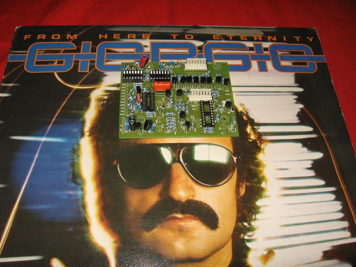

There are actually some PCBs and PICs left from the last run, so
if anyone is interested then please send a PM.

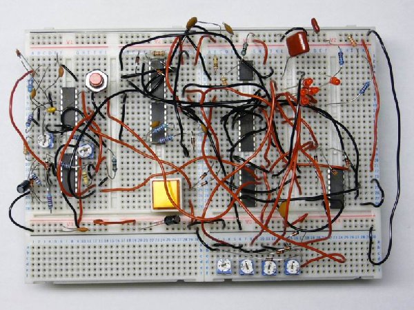

Originally I did design this circuit without the PIC, just using 4017s
and AND gates etc.
It worked pretty well, even had the 4-gate modes, but really quite complicated wiring.
Here is a picture of the prototype ! [without all the switches and only 4 channels wired up]
-ryk

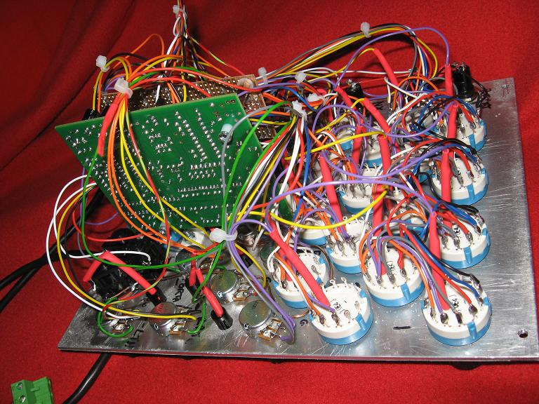

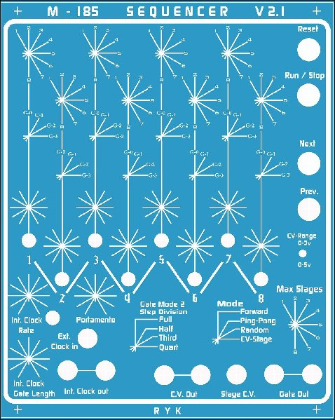

I finally got my panel design laid out on CorelDraw 12 , The stage counts & gate modes look close together but i am using Tall knobs for the 8 ways and short ones for the 4 ways , i've shoehorned the design into 200mm wide (8") by 250mm high (10") , all of my single panels in my modular system are 100mm X 250mm , so this is my first double module Smile.
i decided to go for a rotary switch design after finding 15 of them in the back of my store cupboard Razz .
Now i need to pop down to the local engineers workshop to get some 3mm alum guillotined.
Dave.

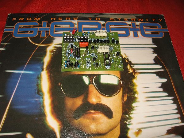

Hello , almost finished populating the pcb , then it's time for wiring up Laughing , i love wiring Confused , here's a pic of the 98% finished pcb and an eyebrow raising 1970's album sleeve from Mr Gorgio Moroder to cheer you up when soldering the M-185 , i hope i'll be sequencing like him when i finish building this Smile heh.
Dave Smile

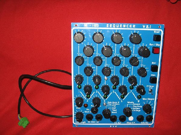

IT'S WORKING !!!
hurrah , finished the wiring , completed & working well , thanks for this amazing sequencer , i love this machine Smile.
Only 3 stupid errors on my part when building this fab sequencer ....
Cv volt range select toggle switch .... i had 2 wires wrong way round .
Start/stop button not working .... bad soldering on R40 leg/pad .
Front panel ..... i drilled a hole for the cv in jack & marked mode 4 as cv stages , oops! i have V2.1 pic and they are not need , nevermind i know how it works and it works just fine Smile heh .
Advice for anyone building this .... read the documentation again & again when designing & constructing, then when you are ready to wire, study that panel connections pdf. intensely Smile
i'll post some mp3's soon , too much fun to switch it off Very Happy
Thanks again ryk.
Dave.
