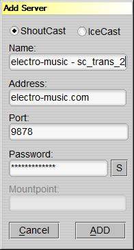

    Under Server, click the Add button
    Set the following information:
    • Select Shoutcast
    • Name : anything you like, it is just a description
    • Address : electro-music.com
    • Port: the port that was assigned to you or 9878 for an sc_trans (DJ) test connection, or 9876 to go live with sc_trans (DJ) (do not use port 9876 for testing - it will go onto the main stream directly).
    • Password: the password that was assigned to you or public for any of the ports 8056, 8130, 8132, 8134, 8136, 8138. Or public:public for an sc_trans connection (ports 9878 or 9876).
    • Mountpoint is to be left blank
    then hit Add

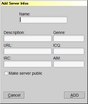

    Next, under Stream Infos click on the Add button
    You can set some general stream info here that will be contained in the stream as meta information. Do not set the 'Make Server Public' option please.
    The Name filled in here is the stream name as it will be sent out along with the stream. You could set an URL to your web site in the URL field, but there are no server tools currently that display this information - likewise for AIM ICQ etc.

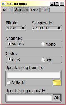

    Again, click the add button, and then in the butt settings screen go to the stream tab.
    Set the following information here
    • Bitrate: 128k
    • Samplerate: 44100Hz
    • Channel: stereo
    • Codec: mp3
    For an sc_trans (DJ) connection (ports 9878 and 9876) you may set a lower bitrate and sample rate (when your upload link does not allow for the preferred settings). Do NOT use different settings for sc_serv (DNAS) connections (ALL ports except 9878 and 9876).
    Update song from file can be used to set song titles from a file, if you want to use that option check Activate and select a file. The file can be made using Notepad for instance, it just needs a song title on it's first line - when the file gets updated the song title in the stream will also be updated.
    Update song manually can be used to set a song title from BUTT itself, type something into the box and hit OK the make the song title be added to the stream. When BUTT was closed and restarted you will have to perform this action again.

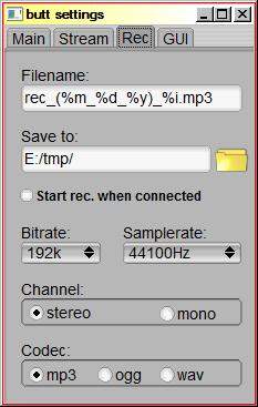

    Then, if you want BUTT to record your outgoing stream go to the Rec tab
    and set it to your likings.
