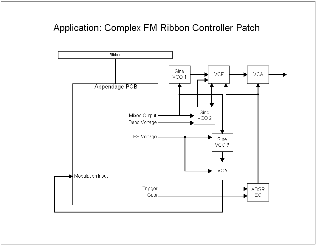

PostPosted: Tue Sep 23, 2008 2:46 pm    Post subject: Reply with quote  Mark this post and the followings unread
Here's a patch that allows you to rule the world with two fingers.
All three VCOs follow the slide voltage. VCO2 is bent up and down even more with the bend voltage. VCO1 and VCO2 provide the signal to the filter and signal VCA. VCO3 is bent by the TFS voltage, and is routed through a second VCA controlled by the TFS back to the modulation input.
With one finger, the first two VCOs track at different values up and down. Pressing two fingers and spreading them apart introduces FM from VCO3. Sliding one finger up from initial bends VCO2 up as the FM is introduced, sliding one finger down from initial bends VCO3 down as FM is introduced. The various movement of the fingers in relation to each other also affects the general pitch of the modulating VCO in different ways, in addition to increasing and decreasing the modulation index.
Bend this mess around
 Filesize:  14.01 KB
 Viewed:  245 Time(s)
