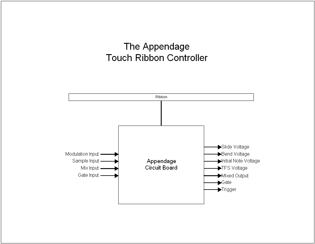

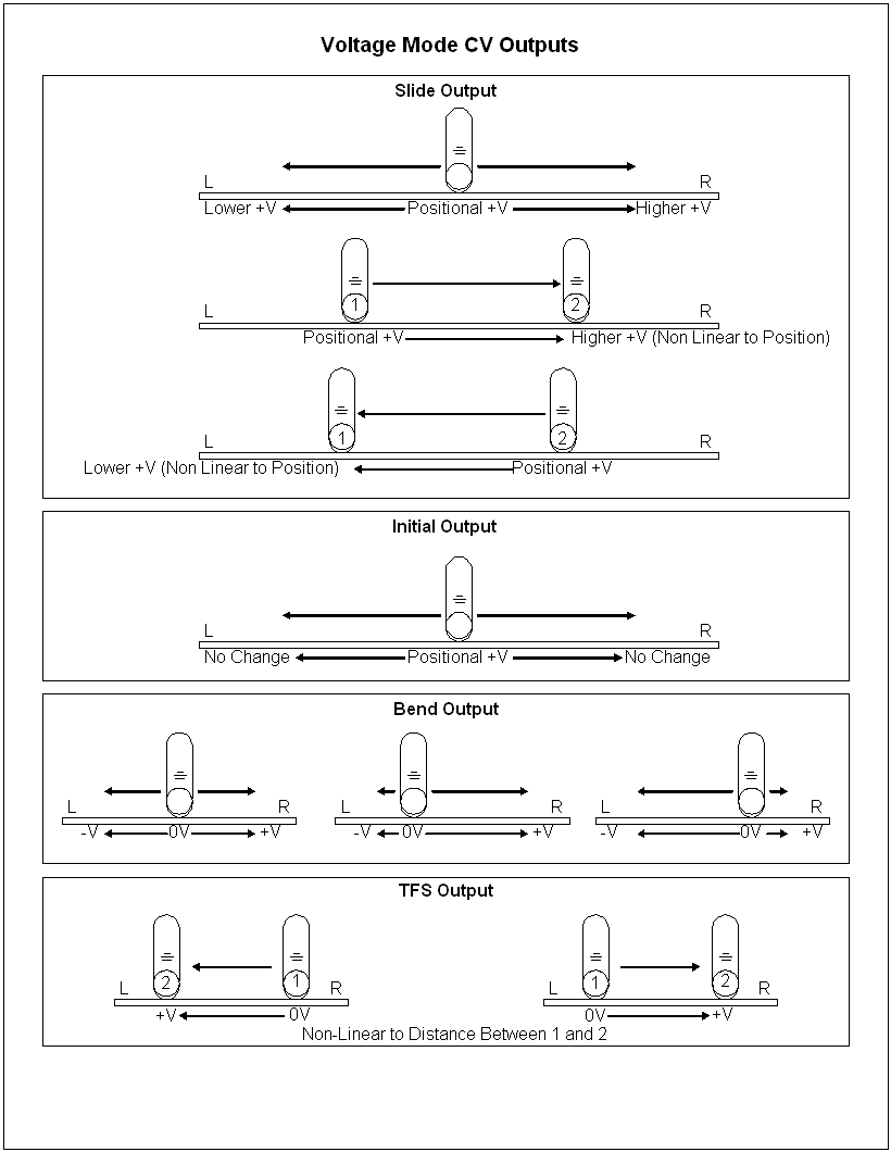

PostPosted: Tue Sep 23, 2008 12:25 pm    Post subject: Reply with quote  Mark this post and the followings unread
Some handy-dandy artwork. And yes, that is a finger that I'm attempting to draw......
Voltage Mode Response
 Filesize:  17.63 KB
 Viewed:  312 Time(s)
Current Mode Response
 Filesize:  18.3 KB
 Viewed:  290 Time(s)

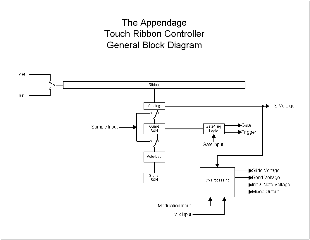

More artwork...
Appendage Gazzins and Gazzouts
 Filesize:  13.98 KB
 Viewed:  296 Time(s)
Appendage General Block Diagram

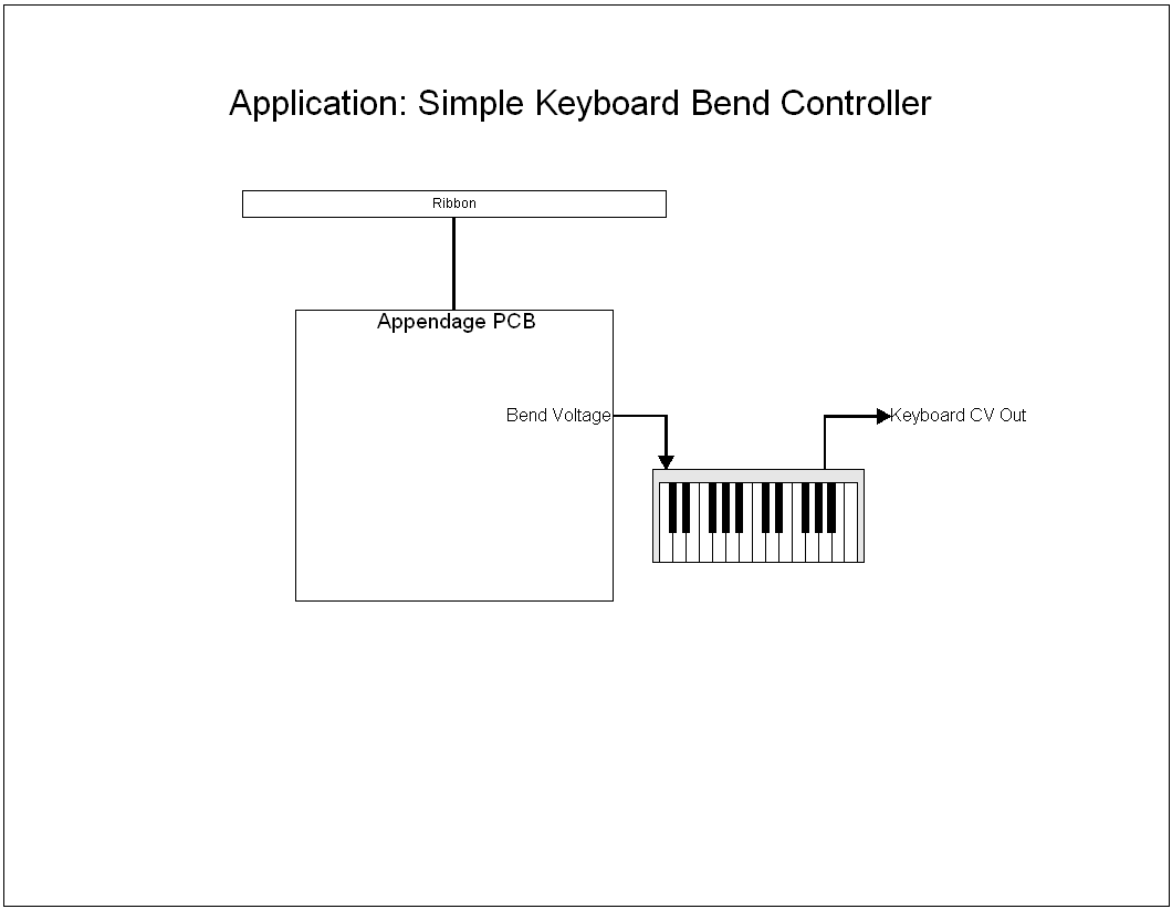

Very basic apps.
I don't think I've mentioned it, but I've got State Machine helping out with PCBs and distribution.
Keyboard Bend

PostPosted: Tue Sep 23, 2008 5:08 pm    Post subject: Reply with quote  Mark this post and the followings unread
I like the new name Scott Cool Mark III Appendage !! The diagrams really sum up the major modes nicely and you have not even touched on the "Hyper Trigger" modes using drum voices. Much easier I think than trying to explain in pure text Wink I never learned so much from getting the finger. Your finger has such perfectly round nails and the knuckle crease, is that a modified ground symbol from your schematic capture? Laughing Oh dear, I must be tired, sorry for the bad humor ........ Embarassed
